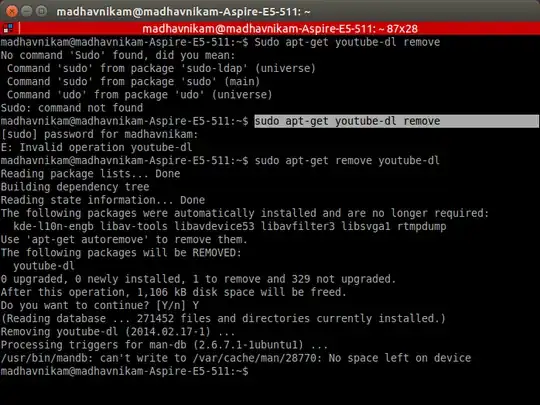

I solve the problem by using these commands:
  1. sudo apt-get remove youtube-dl
    remove youtube-dl

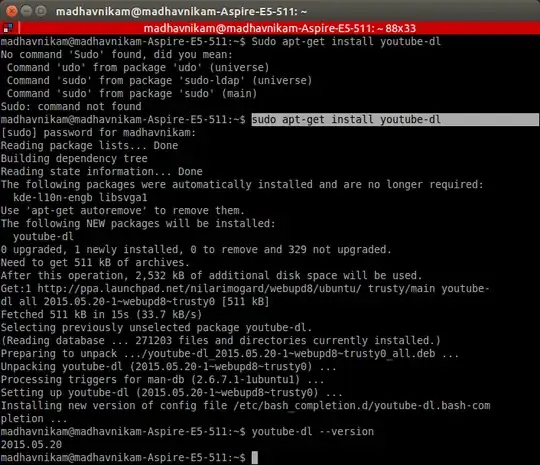

    After that:
  2. sudo apt-get install youtube-dl
    install youtube-dl
