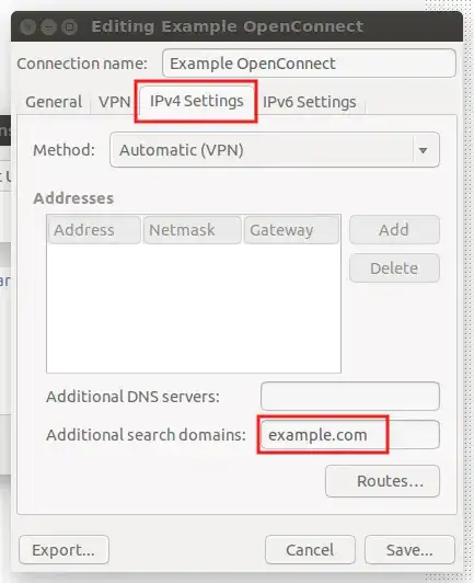

In my case, I need to resolve server.example.com (and was not getting any result).
The solution for me was to go into the VPN settings and add example.com as an additional search domain:
Don't forget to disconnect VPN and then re-connect for the setting to take effect.
