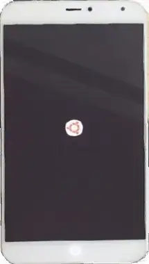

My device froze! The screen is black, and adb shell can't connect to it.
I have tried to to recover using recovery mode. While holding down the home button and volume, the phone display a logo of ubuntu, and I can enter adb shell, but apt-get can't be run:

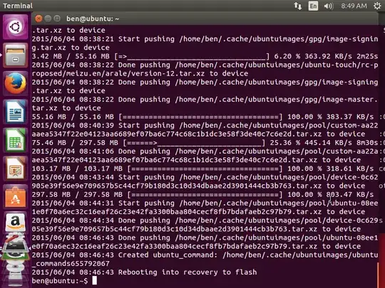

6.4 new My dear friends, I come back. Today I have tried :ubuntu-device-flash,but unluckly.
Someone tell me :
 ubuntu-device-flash touch --device arale --channel ubuntu-touch/rc-proposed/meizu.en --recovery-image recovery.img --bootstrap
and :
  ubuntu-device-falsh -v touch --device arale --channel ubuntu-touch/rc-proposed/meizu.en --recovery-image recovery.img --bootstrap
When files downloaded, My ubuntu host is freezen!
---------23:44 asia/shanghai------
That I have a problem operation to enter fastboot mode.
that's ok now!
thanks.
At last,I think this pictures can help other people.
Flash process
Flash process is freezing
frozen phone picture
