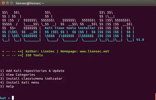

is a script that helps to install Kali Linux tools on your Linux distribution of choice. Those who like to use the penetration testing tools provided by the Kali Linux development team can effectively do that on Ubuntu by using Katoolin. The following instructions are for installing Katoolin on Ubuntu 15.04. These instructions also work on all other currently supported versions of Ubuntu.
  1. Open the terminal and type:
    sudo apt-get install git
    git clone https://github.com/LionSec/katoolin.git && sudo cp katoolin/katoolin.py /usr/bin/katoolin
  2. Make /usr/bin/katoolin executable.
    sudo chmod +x  /usr/bin/katoolin
  3. Run Katoolin as follows and you will see the Katoolin interface:
    cd /usr/bin/
    sudo ./katoolin
    When you go to View Categories and then enter 0 for all, the installer will immediately return to where you were. Scroll up, and you may see that a number of the packages can't be found. Those packages are no longer maintained or have been removed from the Kali repositories. If this happens the best option is to install Kali linux tools one tool at a time in a series of distinct steps.
