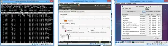

EDIT: Here is a comparison of Ubuntu Server, Ubuntu MATE and Lubuntu, freshly installed and updated on a Virtual Machine. enter image description here

The server versions of Linux tend to take up less resources than the Desktop versions. So, the netbook should be able to handle any of those. As far as your second question, I would say only if you plan on your system typically being idle. That said, your 2 GB of RAM should be more than enough for what you're looking for (unless you end up demanding the server much more than it seems like you intend to).
Colonel Trogdor
  • 1,663
If you really want to be able to compare apples to apples, I would set up Wordpress to your specifications and compare performance there. The problem with comparing those three distributions' idle RAM performance as a basic install without Wordpress is that it's just testing how much it uses sitting there.
Most of the desktop distros' overhead is probably related to the operation of the GUI environment - probably very little that Wordpress relies on is installed by default. On the other hand, Ubuntu server's RAM usage overhead (depending on what choices you made when you installed it) may very well include a lot of things that Wordpress depends upon or utilizes.
Additionally, running a GUI on a machine intended to be a server merely consumes resources and adds potential vulnerabilities. Especially since you say you're new to this, and you're self-hosting a public website, I would keep it as secure as possible. Ubuntu Server (or another server-focused distro like Debian or CentOS) would probably be easier to secure.
