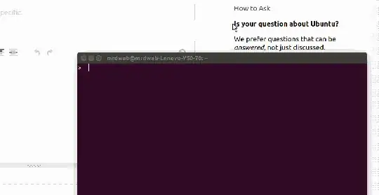

The following gif shows the behavior of (1) first copying without going to the end of the line and (2) second copying with going to the end of the line, and how the result is different in the terminal. Notice the relationship between what was copied and the prompt.
The application that I'm using which makes use of xclip would not read anything in with the first option, and would read the line correctly with the second option.
