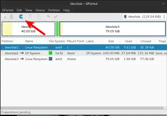

2- Select the swap partition and resize it to a maximum of 2048Mib (the equivalent of 2Gib). To do that, there's a button in the top menu (view image):
NOTE: do not use my partition table.
3- Resize the root partition (mount point /) to something like 25Gib (it depends on your needs, it can be way larger if you want).
4- Now, with the free space remaining, create a new primary-ext4 partition with mount point set as /home.
Now, you'll have a standard partition table, with a root partition, a home partition and a swap partition.
