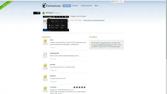

You need to go to extentions.gnome.org - I have to use firefox not Chrome.
NetSpeed is here
Click the On / Off slider, so it goes on and it will be installed:
Then press Alt+F2 and type r then press enter.
It should be in the top panel.
