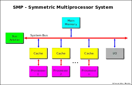

I think CPU cores are best-explained in relation to Symmetric MultiProcessing (SMP).
Intel Core 2 Duo Diagram to show the physical layout. enter image description here
