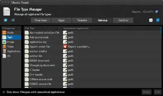

I guess the best advanced option gives you Ubuntu Tweak tool.
Here you can set your default (desired) app to any format/extension.
More detailed described here
