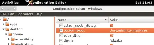

As to redisplaying the minimize-maximize and close decoration back-into gnome-shell - just use gconf-editor and change the key shown - note the position of the close - minimize - maximize buttons
