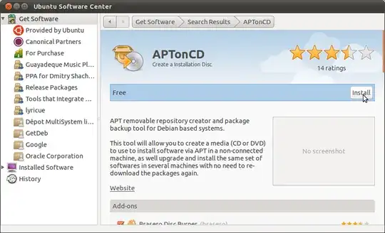

You can use an application called APTOnCD to create a backup of all the applications you have installed. It's in the Ubuntu repos and you should be able to find it in the Ubuntu Software Center.
