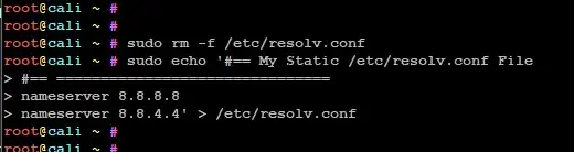

Remove this file and regenerate it:
sudo rm -f /etc/resolv.conf
sudo echo '#== My Static /etc/resolv.conf File
nameserver 8.8.8.8
nameserver 8.8.4.4' > /etc/resolv.conf
nameserver 127.0.1.1 in resolv.conf won't go away
Now you will see that the link is no longer there and your static /etc/resolv.conf file is present.

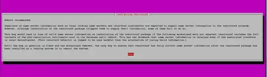

Now to configure resolvconf NOT to regenerate the default /etc/resolv.conf file so your static file persists after reboot, execute the following command:
sudo dpkg-reconfigure resolvconf
ON the first screen, hit your tab button to select NO
configure resolv.conf to persist after reboot
ON the second screen, press your tab key to select OK and hit enter.
configure /etc/resolv.conf to persist after reboot
Your /etc/resolv.conf file will persist after rebooting your server.
