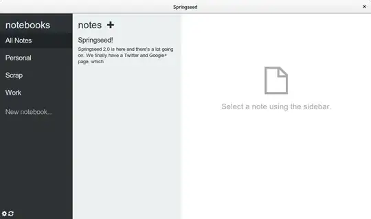

Install libgcrypt11
Open a terminal and download the latest Utopic version for libgcrypt11:
cd
wget http://mirrors.kernel.org/ubuntu/pool/main/libg/libgcrypt11/libgcrypt11_1.5.4-2ubuntu1.1_amd64.deb
Download the latest Springseed version here, eg:
wget http://cdn.michealharker.com/dl/springseed_2.0_amd64.deb
Install with:
sudo dpkg -i libgcrypt11_1.5.4-2ubuntu1.1_amd64.deb
sudo dpkg -i springseed_2.0_amd64.deb
And it works in Ubuntu 15.04 as well!
