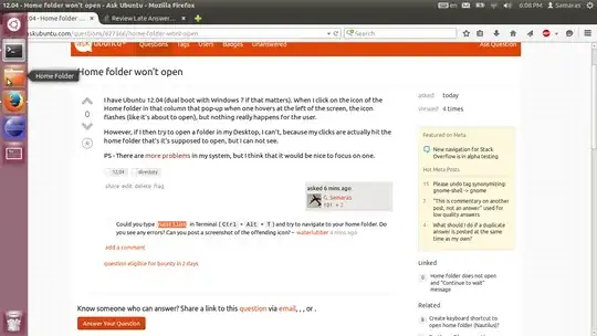

I have Ubuntu 12.04 (dual boot with Windows 7 if that matters). When I click on the icon of the Home folder in that column that pop-up when one hovers at the left of the screen, the icon flashes (like it's about to open), but nothing really happens for the user.
However, if I then try to open a folder in my Desktop, I can't, because my clicks are actually hit the home folder that's it's supposed to open, but I can not see.
This is the icon: enter image description here

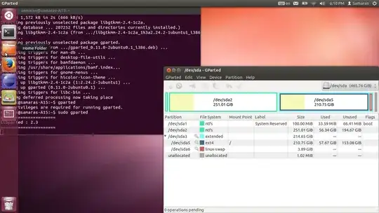

gparted output:
gsamaras

Apparently, you can access your home folder as root. Does ls /home/samaras/ work, and return anything of interest? If so, I would try using another file manager as @muru suggested. I would also run gparted and see if there are any anomolies.
