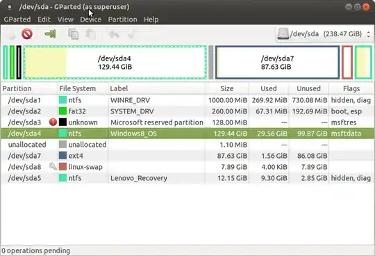

Here is a screenshot of my hard drive partition:
I have no idea where I went wrong.
Boot your Ubuntu system and then enter in the terminal:
sudo grub-install /dev/sda
