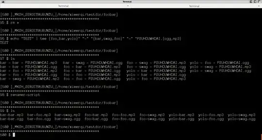

Script
#!/bin/bash
# Author : Serg Kolo
# Description: script for renaming files
# for http://askubuntu.com/q/626258/295286
for file in *; do
        FILENAME=$( awk -F '-' '{gsub(" ","");print $1"-"$2}' <<< "$file")
        EXTENSION=$( awk -F '.' '{print $2}' <<< "$file")
        mv "$file" ./"$FILENAME.$EXTENSION"
done
Results
