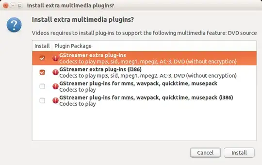

I recently wanted to play a commercial DVD in my computer's built in DVD drive. So I the inserted Faulty Towers DVD into my DVD drive, and then told it to launch it in Videos, and it just gave me this:
Install extra multimedia plugins
But I remember that when I tried to install these plugins in the past, even though the installation was successful, the DVD still does not play. I have already looked at this question and its answers, and they do not help: Why does my optical drive not play commercial dvds?
