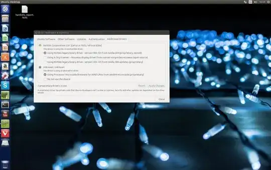

This is first time im installing ubuntu, after i installed it and updated my pc crashed few times (display just suddenly freez and show a lot artifacts). I found that my openGL renderer was unknown After i changed driver, openGL renderer now identified correctly Pc dont crash anymore, but still all animations shutter hard and overall video performance is slow.
I have no idea how to solve this, but it feels like video dont have enough video memory.

This integrated video adapter GeForce 7025 / nForce 630a never worked well with proprietary nvidia-304 drivers. It works quite well with nvidia-173, but it is not supported in Ubuntu 15.04, as far as I know. I would suggest one of these solutions.
  1. Try open source driver. It should work quite well for this chip.
  2. Install Ubuntu 14.04 LTS with nvidia-173 driver.
