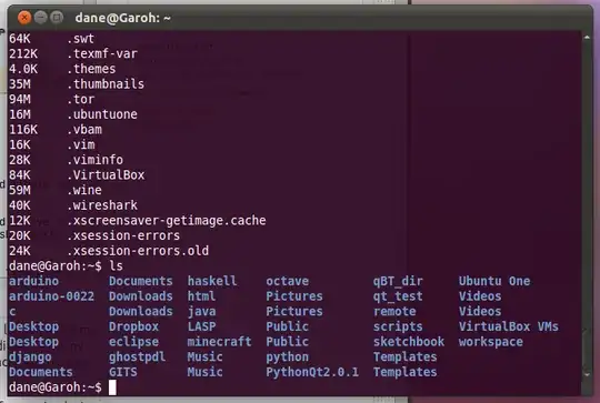

Then I did an ls on my home folder. This is what I saw:
https://i.sstatic.net/Y87fH.png
It appears that all of the default folders that Ubuntu creates are duplicated within the same folder. I didn't know that was even possible.
When I cd into Music, it's empty, but there's another Music folder there, and I have no idea how to get to it. I'm not even sure my files are in there, because du -sh reports that both copies of the music folder are just 4.0k
However, if my music collection were actually gone, I should have a lot more free disk space.

I have had exactly the same thing. Twice. No idea why.
Thankfully, you can delete the duplicate files / folders. You can prove to yourself that they're all there by doing ls -a in your home directory from the command line.
When you boot up, and are at the login screen, press Ctrl+Alt+F1. Login at the command prompt.
Here's a little script in ruby that should fix the issue (you may need to do sudo apt-get install ruby first to install, then run the following file from your home directory):
      #!/usr/bin/env ruby
      all = `ls -a`.split("\n")
      some = all.uniq
      some.each { |a| idx = all.index(a); all[idx] = nil }
      all.compact.each { |dup| `mv "#{dup}" "duplicate00_#{dup}"`}
(Note: I haven't tested this. It should be reasonably safe though so long as you have no other filenames starting duplicate00. No guarantees though!) This will find all the duplicate filenames and rename the newer ones duplicate00_filename. You can then view the folders in Nautilus, move any files you wish to save, and then delete them safely. If it happens again, run the script but change the destination filename to duplicate01.. etc.
