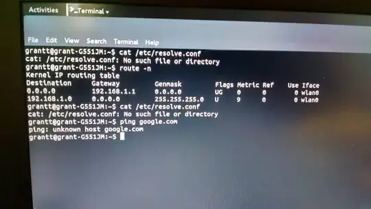

My computer has ubuntu 14.04 and appears to be connecting to the internet. When I use firefox and try to connect to a site I get the message "Server not found."
The strange thing is that I'm able to connect and use the internet on my laptop that has Fedora 21 on it. Same with my phone.
I've tried reseting the router which doesn't work. The problem also persits for all users on my computer.
Anyone have any idea what could be the problem?
Output: Output
If /etc/resolv.conf does not exist. You must create one and enter the nameserver line
For Example
nameserver 8.8.8.8
Where 8.8.8.8 is the Google DNS Server. You need to put in your DNS Server IP Address.
Note:- /etc/resolv.conf Should automatically get generated but if it is absent you need to create it. After that it should stay there.
