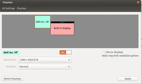

How can I use the command prompt to do get the setup shown below?
Edit: I need the secondary display to be located to the left and half-way to the top of the primary display, as shown above.

Try this:
xrandr --output eDPI1 --mode 1024x768 --pos 0x0 --rotate normal --output HDMI2 --mode 1366x768 --pos 1024x384 --rotate normal
