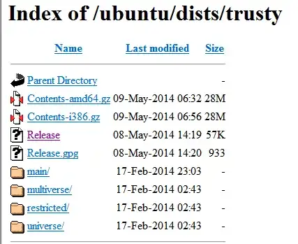

Ok I may have an answer for you why this is happening but a solution is not withing my reach.
Look at this.
Missing Partner Repo In.archive.ubuntu.com
Similarly
http://dl.google.com/linux/chrome/deb/dists/stable/
is also not reachable
Also
http://downloads-distro.mongodb.org/repo/ubuntu-upstart/dists/dist/
was not reachable when you posted the question. But if you do a sudo apt-get update you should not get an error for
This is available now.
So I recommend you to wait for some time till the issues with the Backend Are fixed. There is nothnig wrong with your system. Just the backend repos are broken at the moment.
