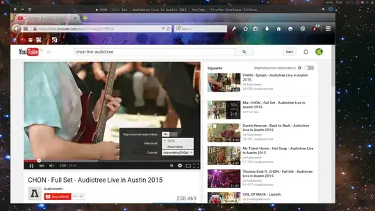

I've been having this issue with Firefox Developer Edition (FDE) on Youtube, where it show videos only in 360p quality, there's also an "Auto" option, which is also, the 360p quality. I'm in Ubuntu 14.04 LTS.
Here's an example of a video that I know is in higher quality because I can see it with Chromium and with youtube-dl.
On FDE:
youtube on FDE

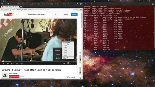

On Chromium and youtube-dl:
youtube on Chromium and y-dl

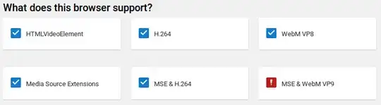

Try installing this add-on onto your Firefox.
Go to about:config in Firefox and set the following properties to true:
  • media.mediasource.enabled
  • media.fragmented-mp4.exposed
  • media.fragmented-mp4.ffmpeg.enabled
To check if it worked you can go to https://www.youtube.com/html5. You should see something like this:
Supported modes
