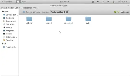

Download a theme>extract it>Inside it should have something similar to this:
As you can see there's a gtk-3.0 and a metacity-1 folder. These two folders should be in: /home/user/.themes/.

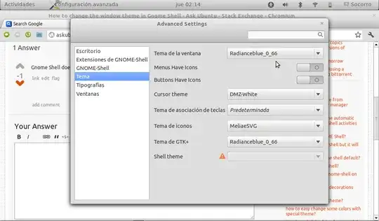

Then open up Gnome Tweak Tool>go to Theme>Window theme>Scroll down to the theme you want. enter image description here
Log out, and done.

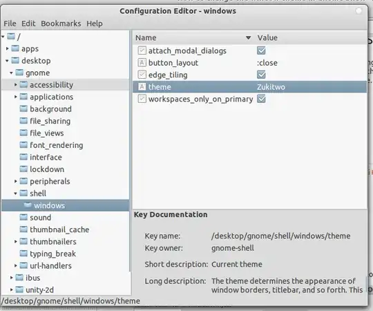

try this:
gconf-editor
and change the theme in /desktop/gnome/shell/windows
