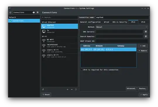

For cpe:/a:kde:plasma-workspace:6.0.3
    1. Invoke System Settings (systemsettings);
    2. Search for "Wi-Fi & Networking".
    1. Access Connections (kcmshell6 kcm_networkmanagement);
  1. Select the network;
  2. Choose IPv4 or IPv6; and
  3. Select the Manual method:

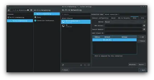

For cpe:/a:kde:plasma-workspace:5.27.10
    1. Invoke System Settings (systemsettings5);
    2. Search for "Connections".
    1. Access Connections (kcmshell5 kcm_networkmanagement);
