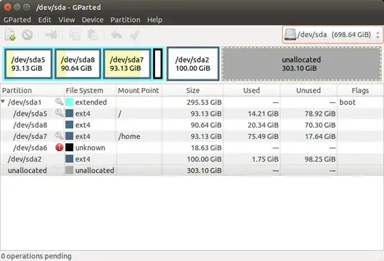

free -mshows 0MB total swap space availabledmays@vipertooth:~$ free -m total used free shared buffers cached Mem: 5875 2238 3636 270 98 1007 -/+ buffers/cache: 1133 4741 Swap: 0 0 0gpartedshows the swap partition as "Unknown"
