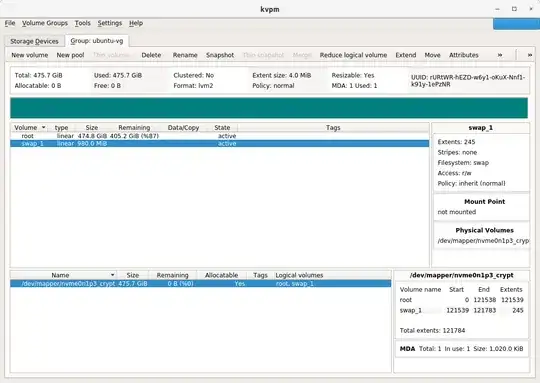

If the accepted answer is too complicated, you can also just let the installer do its thing, then boot Ubuntu and install the LVM manager kpvm. With it, you can delete the swap partition and resize the root partition to use that space.
kpvm screenshot with swap volume
