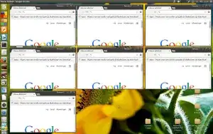

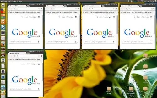

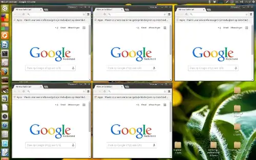

A different approach is to arrange the windows form a pre- defined(customizable) grid (columns/rows)
An example:
rearranged into (cols set to 3, rows set to 2):
rearranged into (cols set to 4, rows set to 2):
The script below can be used to do that. As said, the number of columns&rows can be set, as well as the padding between the windows. The script calculates then the positions the windows should be arranged into, as well as their sizes.

Dynamic version
below a dynamic version of the script, as requested in a comment. This version of the script calculates the number of columns and rows, depending on the number of windows. The proportions of the rearranged window(s) is similar to the proportions of the screen.
The setup and the use is pretty much the same as the version above, only the number of columns and rows is now set automatically.

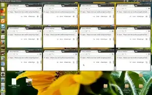

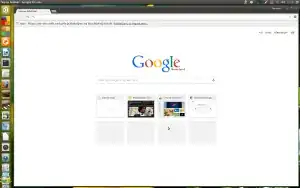

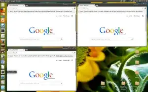

See below the examples with a varying number of opened windows:
