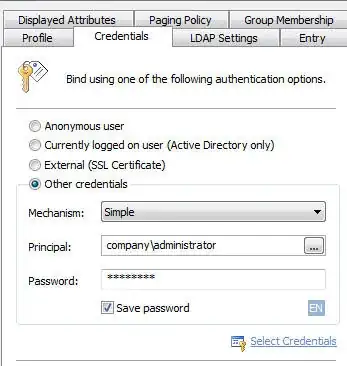

  • I am able to bind with LDAP browser with the user:
    company\administrator
    password

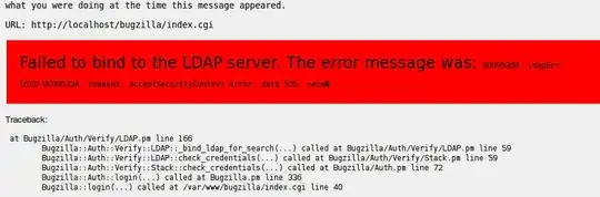

I get the error:
Failed to bind to the LDAP server. The error message was: 80090308
