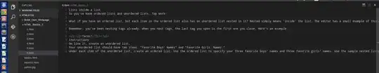

I couldn't locate it in User Preferences. Here's the screenshot which has a lot of comments that I'd like to wrap:
Enter image description here

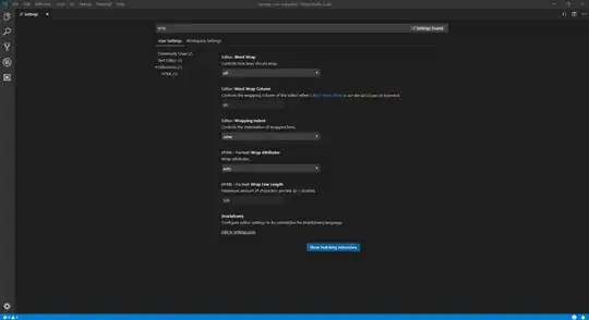

File > Preferences > Settings
New Setting UI (Searchable )
Settings UI now Search Powered
Just Search Wrap / Word Wrap
  • editor.wordWrap: "off" - Lines will never wrap. editor.wordWrap: "on" - Lines will wrap at viewport width
  • editor.wordWrap: "on" - Lines will wrap at viewport width.
  • editor.wordWrap: "wordWrapColumn" - Lines will wrap at the value of editor.wordWrapColumn.
  • editor.wordWrap: "bounded" - Lines will wrap at the minimum of viewport width and the value of editor.wordWrapColumn.
References: https://code.visualstudio.com/updates/v1_10#_word-wrap-settings-redesign and info from @jermila-dhas

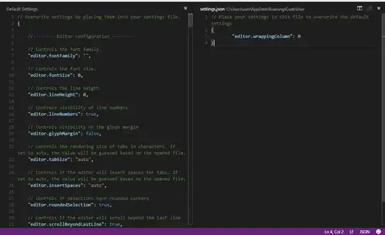

File > Preferences > User Settings
For Beginner
Paste the following in settings.json
// Place your settings in this file to overwrite the default settings
{       "editor.wrappingColumn": 0 }
That it, it is that simpler, but probably we will having someone open source user interface for json settings.
For Intermediate User
If you already have settings.json, just add
As the settings is in JSON, last settings are without the comma , and setting is ending with } as you see in Default settings and the settings.json overide all the Default settings
If you are using visual studio code v1.10, the setting "editor.wrappingCloumn" has been deprecated.
Use "editor.wordWrap": "on" instead.
More information can be found here
