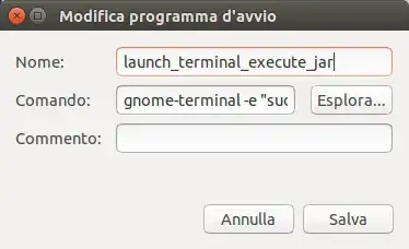

  1. Hit the Super key, type "Startup Applications" and hit Enter
  2. Name you command, type the name in the "Name" field and type the command in the "Command" field
  3. Click on "Save" and click on "Close"
image-1
