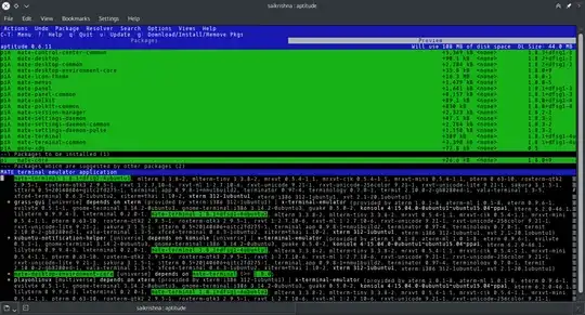

If you use aptitude or a graphical package manager (Synaptic, etc.), then you can unselect which packages should be installed as long as it doesn't cause a dependency issue.
In the case of aptitude, before installing a package (in the graphical view), it will show you why a dependent package is being installed. In my case, I use KDE, and so don't have any MATE packages. If I tell it to install mate-core, I get the following:
Notice that mate-core is marked as being manually installed, and many other packages are being installed. For the mate-terminal package, in the bottom, it says, "mate-desktop-environment-core [universe] depends on mate-terminal (>= 1.0.0)". Going over to the entry for mate-desktop-environment-core,
"mate-core [universe] depends on mate-desktop-environment-core (>= 1.8.0+9)". This is why mate-terminal is being installed.
If, instead, a recommended package is being installed (rather than something that is dependent on another package), aptitude will tell you so, and you can tell it not to install that package without any broken dependencies. For example:
