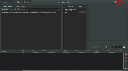

When I try to minimise Pitivi using the minimise button:
Screenshot of Pitivi with button highlighted
It crashes all of Ubuntu. By this, I mean the monitor stops receiving an input, then the computer makes the restart noise and it goes onto the log-in screen. I'm using Ubuntu 14.04 and Pitivi 0.94 (64 bit), and I have 8 GB of RAM (I don't know if that's relevant)
