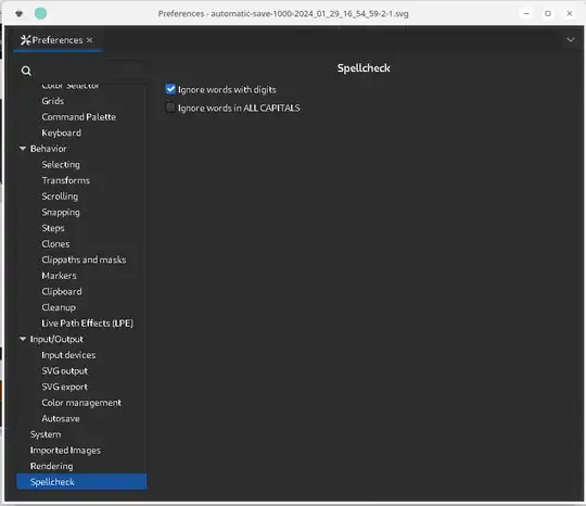

You may also try using Inkscape to edit your PDF document, which may have better results with some files, provided that the required fonts are installed. Make sure that spell checking is enabled in Edit > Preferences:

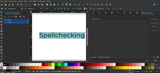

Then, go to Text > Spellcheck to open the spell checking dialog
