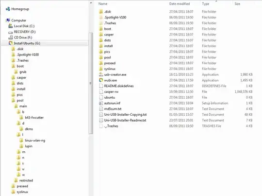

UPDATE: Here is what I see when I plug the USB stick into Windows My filesystem

I managed to get it to work by resizing the casper-rw file using this tool.

Since you have used the Universal USB Installer from pendrivelinux.com you need to use a tool that allows you to resize the casper-rw file in your USB's root.
Download TopoResize and unzip it's contents.
Open toporesize.bat from the TopoResize folder to start the program.
Once the application starts
  1. Click find file and navigate to the casper-rw file you would like to resize
  2. Drag the slider to the desired capacity, (3) Click Resize fileresize casper-rw using TopoResize
That's all there is to it.
If all goes well, you should now have a resized casper-rw partition and the no space errors will not show anymore.

You can mount casper-rw and access files within using:
sudo mkdir /media/casper
sudo mount -o loop casper-rw /media/casper/

It depends on how you made your Live USB stick. Did you make it with a persistence file? That option is present when you make the USB with either the Ubuntu USB creator or UNetBootin. If you didn't make a persistence file then all the files or changes you make will be lost on reboot. If there is a persistence file, and your USB wont boot its possible to explore the USB on a different system and see if you can find your files in the home folder or other directory you downloaded them to.
