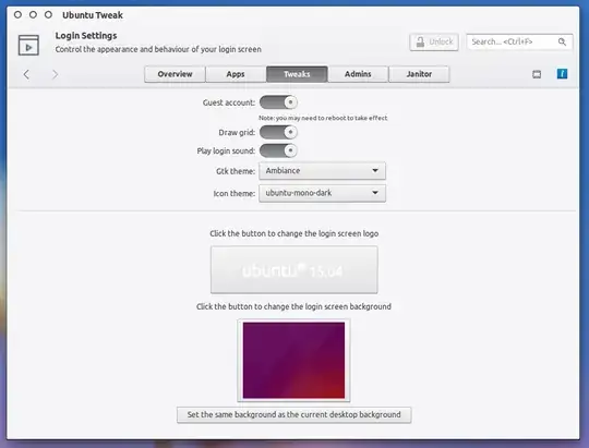

  1. Install Ubuntu Tweak. It still works although it hasn't been updated for a while. You can download the deb package from here: https://launchpad.net/ubuntu-tweak
  2. Start Ubuntu Tweak, go to Tweaks > Startup > Login Settings. There you should be able to "Unlock" Root privileges and select some LDM Preferences like "Draw Grid".
