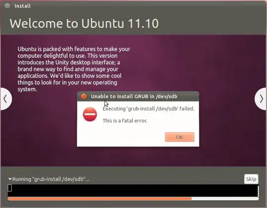

Unable to install GRUB in /dev/sdb
Unfortunately (as you can see) I cannot install grub. I have tried /dev/sda as well.

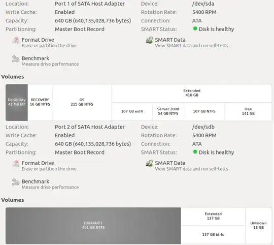

Here is my partitioning schema:
My partitioning schema

So I download 11.10 x64 Beta on my old laptop, push it to a USB, and attempt to install it on my other hard-drive.
Then I get the first mentioned error. I have also tried (before and after) running sudo grub-install manually on the respective drives, to no avail.

I got the same error message. The installation configuration that led to this message is as follows:
/dev/sda1        ntfs :windows partition
/dev/sda2        ntfs :windows partition
/dev/sda3        ntfs :windows partition
/dev/sda5             :swap  partition
/dev/sda6        ext4 :/     partition
/dev/sda7        ext4 :/home partition
/dev/sda8        ext2 :/boot partition
So, what worked -after lots of tests- is the configuration where I have changed the ext2 format of the /boot partition (/dev/sda8) to the ext4 format. I don't know if the problem was really in that point but at last it worked. I hope this will be helpful.

I don't believe grub reliably supports booting a btrfs partition, you'll either have to use a separate ext4 formatted /boot or just use a ext4 /.
I think trying to use grub with a btrfs / works in some cases but not others. It's not very well tested yet.
