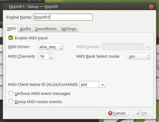

  • configure QSynth to Enable MIDI Input by checking the box in Setup > MIDI
  • configure QSynth to use alsa Audio Driver under Setup > Audio

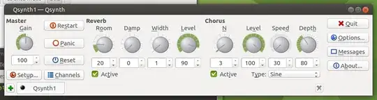

Setting up QSynth
For me, this program is in Sound & Video -> QSynth.
You can also start it from command line, starting it with the qsynth command.
qsynth main window screenshot

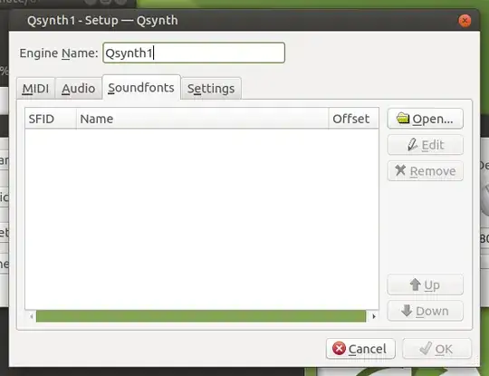

  1. Click Setup... on the main window
qsynth setup window
  1. Go to the soundfonts tab
qsynth soundfonts
  1. Click Open to select a soundfont.
There are some soundfonts in /usr/share/sounds/sf2, you can use these, or provide your own.
Personally I selected FluidR3_GM.sf2 for this test for convenience's sake, because it appears to be downloaded with Fluidsynth but for my own use I use SGM-v2.0.1.sf2

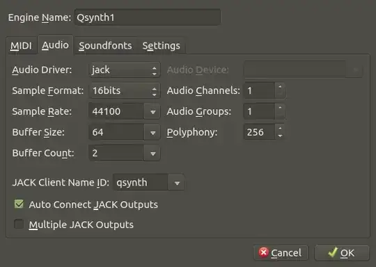

In Ubuntu 19, a user LKTS points out that you may need to also do this step:
  1. On the Audio tab, set the Audio Driver to "jack" screenshot of the Audio tab in QSynth
Click OK, and let it restart the fluidsynth engine. You're done with QSynth but leave it open.

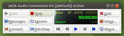

This tutorial will use QJackCtl. For me this program was found in Sound & Video -> QJackCtl, but you can also start it command line with qjackctl.
The main window of the UI will look like this:
jack main window screenshot

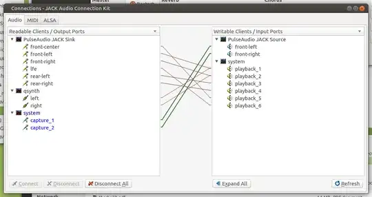

  1. Click the Connect button to show connectable devices.
  2. Expand All Nodes, your Audio tab should look something like this:
jack connections: audio tab
Notes about the audio tab
  • I didn't have to do anything here (it was wired up like this by default), but here's some information about this tab:
  • The "PulseAudio JACK Sink" inputs are connected to the "system" outputs (playback_1-6), you can think of these playback_# outputs as your speakers.
  • capture_1 and capture_2 represent my microphone.
  • qsynth left and right are also connected to my speakers, this is how we will hear the midi events (notes) being played through RoseGarden while we are composing.
  • If your audio tab is not set up correctly, you may not hear system sounds or Rosegarden sounds.

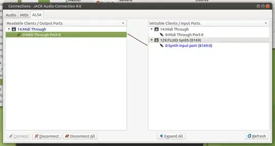

ALSA Tab: Connecting FluidSynth
  1. Switch to the ALSA tab and expand all nodes, it should look something like this:
jack connections: alsa tab, before connection
  1. Click and drag to connect a wire:
  • from: 14:Midi Through/0:Midi Through Port-0 on the left
  • to 129:FLUID Synth (8169)/0:Synth input port (8169:0) on the right
The numbers on these entries may be different on your system.
After you do that, it should look like this:
jack connections: alsa tab, after connection
We're done in this window, close the connections window, but leave the Jack window open.

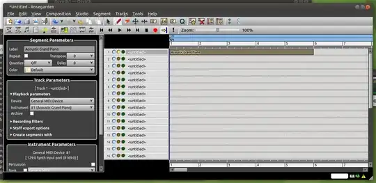

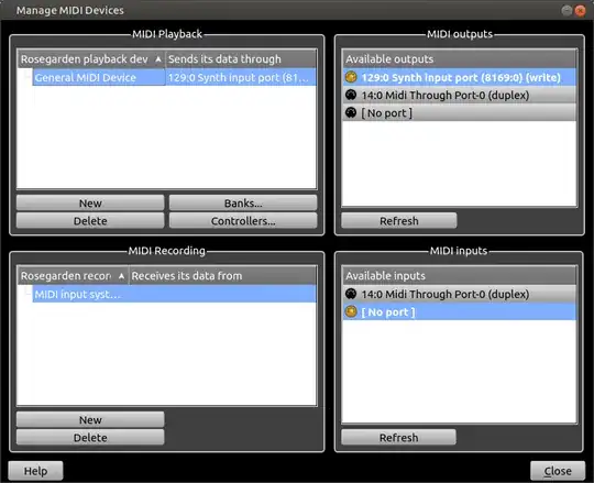

1. Configure Midi Devices
In the main menu, click Studio -> Manage MIDI Devices
Your setup should look something like this:
RoseGarden Manage Midi Devices window screenshot
2. To test our setup, using the pencil tool, just draw a track somewhere
RoseGarden showing drawn track

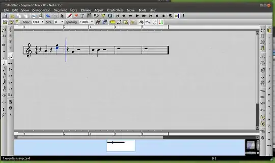

3. Double click on that track
4. Click to insert notes on the staff
You should hear piano sounds coming from your speakers when you click to insert a note.
Rosegarden staff editor screenshot
