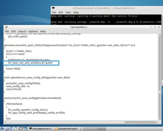

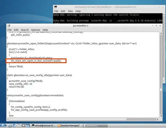

  5. Edit the pcmanfm-0.9.10/src/pcmanfm.c file.
    leafpad pcmanfm-0.9.10/src/pcmanfm.c
  6. In Leafpad, search for the line fm_main_win_open_in_last_active(fi->path); (should be somewhere around line 420 and change it to fm_main_win_add_win(NULL, fi->path);. Save the changes and close the file. See the screenshots if it isn't clear:
    Before:
    code earlier
    After:
    code after editing
