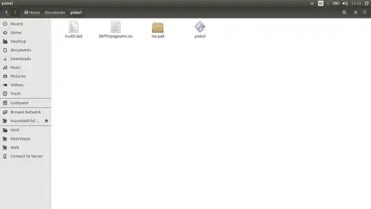

I downloaded a program called piskel from here and I have no idea how to run it or install it. This are the files that where inside:
Maybe someone can point me in the right direction. Thanks.
