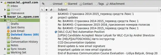

I installed ExQuilla according to this tutorial After Installation: Creating an Exchange account. For accessing Microsoft Exchange Account.
And I accessed my MS mail without any trouble:
Thunderbird looking
But this soft is not free. And license will be over 2 weeks.
Which free alternatives are possible for the same purpose?
