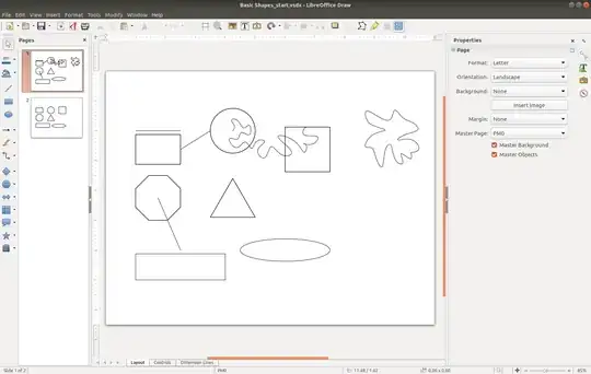

With LibreOffice Draw 6.0.7.3 the *.vsdx Files from Microsoft Visio Standard 2016 that I have created there recently could be opened. Tested on Ubuntu 18.04.
LibreOffice Draw

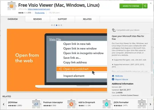

Try the "Free Visio Viewer (Mac, Windows, Linux)" add-on in Chrome, by LucidChart. I just tried it in Ubuntu 14.04. It seems to work well.
