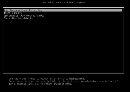

  1. Connect the USB drive to your tablet and power it on
You should be presented with a screen like this, choose "Try Ubuntu without installing" enter image description here
