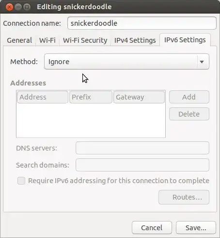

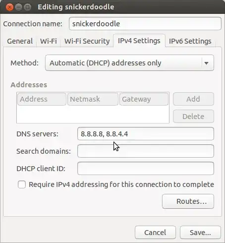

Go into network manager and remove wireless connections then reboot and set the settings to match the screenshots.DNS SETTINGSIPV6 SETTINGS
Also reboot your router.
