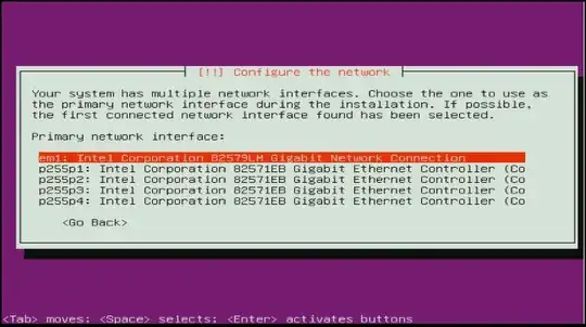

I'm trying to setup an unattended Ubuntu Server 14.04 installation from PXE.
I initially tried using Kickstart. This worked okay except that the partition manager required user confirmation and so wasn't a fully unattended install (i.e. I'd need to acknowledge that it's okay to repartition the disk part way through the installation).
A colleague suggested that, for fine-grained control, I'd be better off using Preseed. Unfortunately, the preseed installation currently gets stuck at the choose_interface section.

but the choose_interface doesn't work automatically:
I've tried both specifying the network interface:
d-i netcfg/choose_interface select em1
and automatic selection:
d-i netcfg/choose_interface select auto
Neither of these settings worked: the installation requires human input in order to proceed.
Can you see what I'm doing wrong?
10
This is (or was?) a reported bug. The solution was to try passing netcfg/choose_interface= YourInterface to the kernel as a boot option.

According to this article, you can edit pxelinux.cfg in append line for multiple interface issue when using preseed.
by interface name
append initrd=/images/Ubuntu/initrd.gz ksdevice=bootif lang= interface=eth1
or with mac address
append initrd=/images/Ubuntu/initrd.gz ksdevice=bootif lang= interface=90:e2:ba:2e:b0:70
