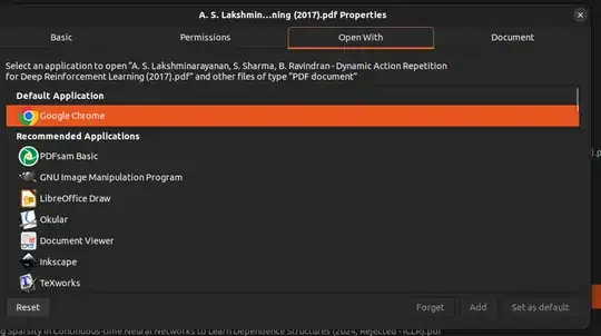

On Ubuntu 22.04 you must set the default by going into the document properties menu. Right Click or Ctrl + I then Open With tab.
Illustration: enter image description here
