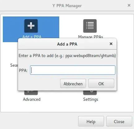

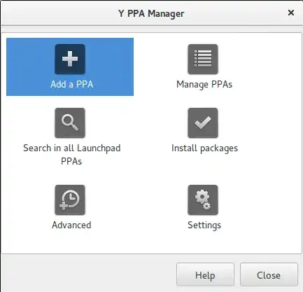

You can use the Y-PPA-Manager, then you do not need to use sudo apt-get update.
sudo add-apt-repository ppa:webupd8team/y-ppa-manager
sudo apt-get update
sudo apt-get install y-ppa-manager
  1. via command-line with, eg:
    sudo update-ppa ppa:webupd8team/y-ppa-manager
  2. via GUI:
