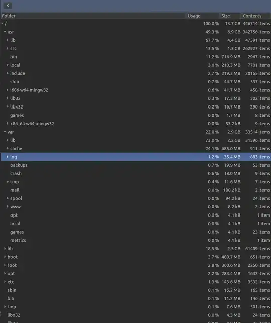

Please let me know if you need further information about the system! System space of root /: enter image description here
