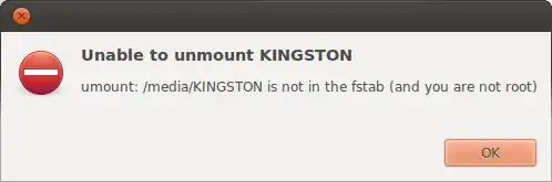

In Ubuntu 11.10 I wrote the rules file (from @enzotib answer), and works, but gives the following message when I try to eject/unmount:
(should I start another question for Ubuntu 11.10?)

Unfortunately I cannot get the desktop right-click unmount to work, but this is not a big problem: having the sync option in place, you can simply unplug the device, and the udev rule take care of removing the entry from /proc/mounts and removing the mount-point.
